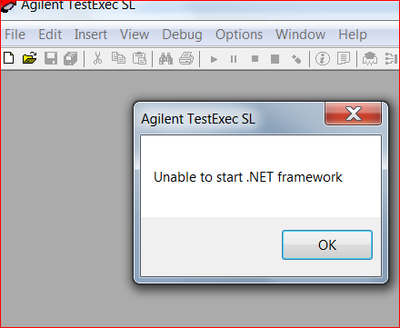

嗨,我得到消息框“无法启动.NET框架”。
出于某种原因,我需要在双启动系统上安装testexec,因此win7在驱动器D上运行:我必须安装Testexec SL。 (如果我在具有默认安装路径的系统上执行相同的操作,一切正常。)安装后,程序启动属性如下所示:+“D: Program Files Agilent TestExec SL 7.1 Bin tstexcsl.exe”/ Platform“ TestExec SL“/版本7.1 /首选项”D: Users Public Agilent My TxSL Files Test Systems Preferences.upf“+ +”D: Program Files Agilent TestExec SL 7.1 bin“+也是。 .NET Framework安装看起来有点不同,但由Microsoft产品带来:+ - Microsoft .NET Framework 4.5 DEU语言包4.5.50709+ + - Microsoft .NET Framework 4多目标包4.0.30319+ + - Microsoft .NET Framework 4.5 4.5.50709+ + - Microsoft Visual Studio 2010 ADO.NET实体框架工具10.0.40219+ + - TestExec SL + 7.1.1系统上不再有.NET 4.0。 但微软告诉我,.NET4.5完全向后兼容.NET4.0在win7事件日志中,我找不到任何细节。 任何expierience? 亲切的考虑安德烈亚斯系统:在win7 32Bit 8GB上有和没有补丁7.1.3的Testexec 7.1.1 以上来自于谷歌翻译 以下为原文 Hi I got the messagebox "Unable to start .NET framework". For some reason, I need to install testexec on a dual boot system, so win7 is running on drive D: an there I have to install Testexec SL. (If I do the same on systems with default installation path, everything works fine.) After installation, program start properties looks like: +"D:Program FilesAgilentTestExec SL 7.1Bintstexcsl.exe" /Platform "TestExec SL" /Version 7.1 /Preferences "D:UsersPublicAgilentMy TxSL FilesTest SystemsPreferences.upf"+ +"D:Program FilesAgilentTestExec SL 7.1bin"+ Also the .NET Framework installation looks a little bit different, but brought by microsoft products: +- Microsoft .NET Framework 4.5 DEU Language Pack 4.5.50709+ +- Microsoft .NET Framework 4 Multi-Targeting Pack 4.0.30319+ +- Microsoft .NET Framework 4.5 4.5.50709+ +- Microsoft Visual Studio 2010 ADO.NET Entity Framework Tools 10.0.40219+ +- TestExec SL+ 7.1.1 There is no .NET 4.0 on the system any more. But microsoft tells, .NET4.5 is fully backwards compatible to .NET4.0 In the win7 eventlog, i can not find any details. Any expierience ? Kind regard Andreas System: Testexec 7.1.1 with and without Patch 7.1.3 on win7 32Bit 8GB 附件 |

嗨安德烈亚斯,我对下面的消息很困惑。
你的意思是在D Drive上运行独立操作系统并且TxSL工作正常吗? 而且你没有错误? 您列出的.NET 4.5 Framework位于何处? 它是在D驱动器中TxSL运行没有问题吗? 以上来自于谷歌翻译 以下为原文 Hi Andreas, I am quite confused with the message below. Do you mean that at D Drive which is running in an independent OS and TxSL works fine? And you do not have the error? Where are those .NET 4.5 Framework that you have listed down located? Is it in D drive where TxSL has no problem running? |
嗨,我也遇到过这个问题。
当我创建.NET样式操作时,TestExec Sl显示“无法启动.NET框架”对话框。 我的系统是Windows 7,TestExec SL 7.1,vs2010,vs2012。 有没有解决方案可以解决这个问题? 或检查任何日志文件以识别出什么问题? 谢谢。 以上来自于谷歌翻译 以下为原文 Hi, I also encounter this problem. TestExec Sl display "Unable to start .NET framework" dialog when I create .NET style action. My system is windows 7, TestExec SL 7.1, vs2010, vs2012. Is there any solution to solve this? or check any log file to identity what's problem? Thanks. |
YHYDZ 发表于 2019-1-15 19:51 你好。 TesExec SL目前不支持.NET framework 4.5。 现在唯一的解决方法是卸载.NET framework 4.5并恢复到.NET framework 4.0。 只有在今年年底发布的TestExec SL 8.0中才支持.NET框架。 以上来自于谷歌翻译 以下为原文 Hi. TesExec SL currently does not support .NET framework 4.5. The only workaround now is to uninstall .NET framework 4.5 and revert back to .NET framework 4.0. The .NET framework will only be supported in TestExec SL 8.0 slated for release end of this year. |
guigui_7044 发表于 2019-1-15 20:03 谢谢weiliang,现在我可以使用它。 以上来自于谷歌翻译 以下为原文 Thanks weiliang, now I can use it. |
嗨Weiliang,TestExec 8.0包含哪些其他变化/新闻? (例如,是否可以使用admin-rights执行它?)Thx 以上来自于谷歌翻译 以下为原文 Hi Weiliang, what other changes/news are included in TestExec 8.0? (For example will it be possible to execute it with out admin-rights?) Thx |
