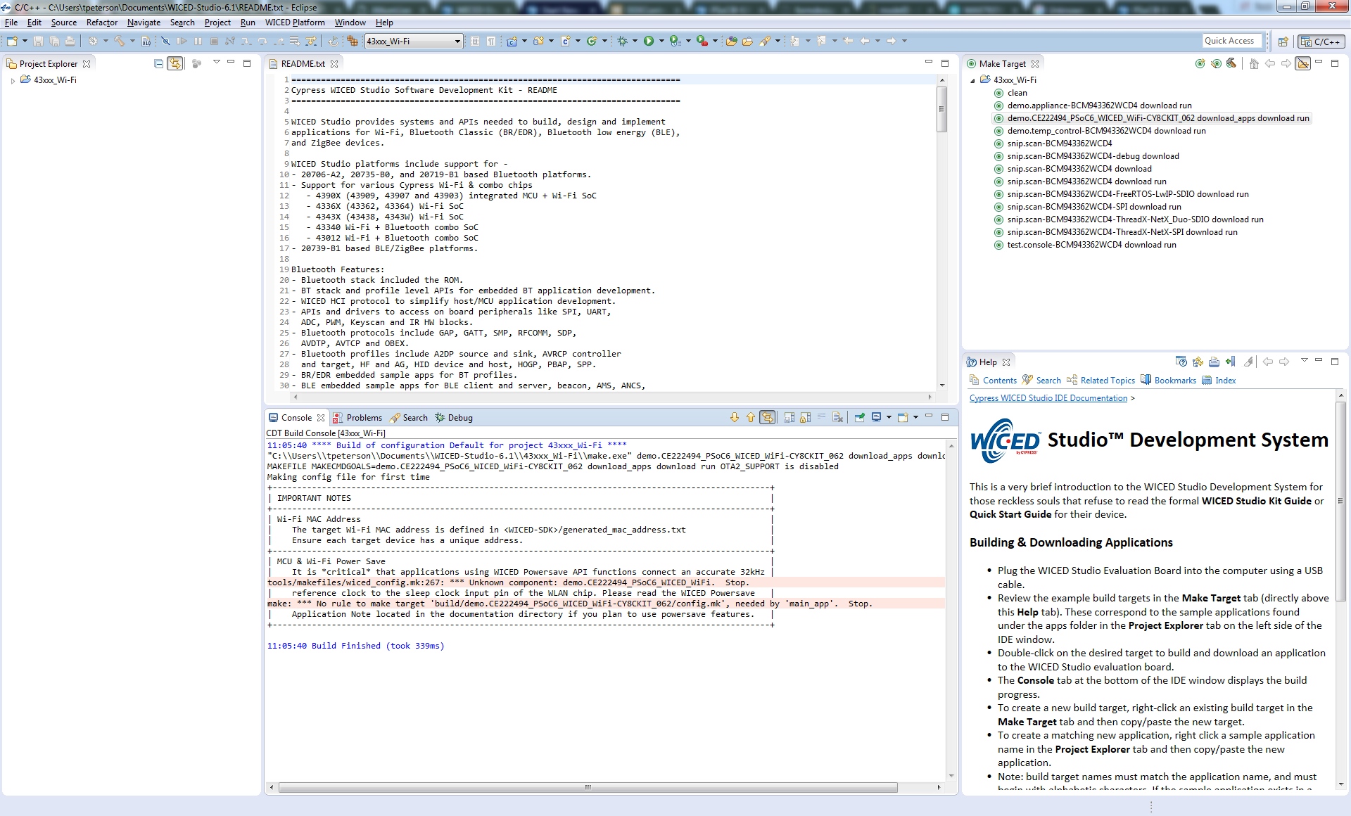

严格按照指示操作。在步骤9中,“双击新创建的制作目标来构建代码,编程工具包,并运行示例。请注意,这可能需要几分钟。“我得到以下输出错误,我不知道如何修复:
11:05:40***构建项目43XXXW-Wi-Fi**配置默认值 “C:TePtErs\Debug WICED Studio1.6\43XXXWi-Fi\Po.exe”DEMO。CE222494OPSo66WICDEDWIVE-CY8CKITY062下载程序下载运行 MaCeCMDMaskObjest= DeMo.CE222494PoS66WiDEDWiFi-CY8CKITY062下载下载运行OTA2A支持被禁用 首次制作配置文件 +------------------------------------------------+ 重要注意事项 +------------------------------------------------+ Wi-Fi MAC地址 目标Wi-Fi MAC地址定义在WICED SDK> 确保每个目标设备具有唯一的地址。γ +------------------------------------------------+ 单片机与Wi-Fi节电 *使用WICE Posivabess API函数的应用连接精确的32 kHz 工具/MaFixFix/WICDEZY CONFIG.MK:267:**未知组件:DEMO。CE222494PPSO66WICDEDWiFiFi。停下来。 参考时钟到WLAN芯片的睡眠时钟输入引脚。请阅读WICED Powersave 制作:没有规则去做目标“构建/演示。CE222494PPSO6WIDEDWIFI-CY8CKITY062/COFIG.MK',需要MeNeIAPP”。停下来。 如果你计划使用PoxSaveStices特性,请在文档目录中找到应用程序注释。γ +------------------------------------------------+ 11:05:40搭建完成(取39MS) PNG 253.9 K 以上来自于百度翻译 以下为原文 Followed the instructions exactly. On step 9, "Double-click the newly created make target to build the code, program the kit, and run the example. Note that this may take a few minutes." I get the following output with error, I don't know how to fix: 11:05:40 **** Build of configuration Default for project 43xxx_Wi-Fi **** "C:\Users\tpeterson\Documents\WICED-Studio-6.1\43xxx_Wi-Fi\make.exe" demo.CE222494_PSoC6_WICED_WiFi-CY8CKIT_062 download_apps download run MAKEFILE MAKECMDGOALS=demo.CE222494_PSoC6_WICED_WiFi-CY8CKIT_062 download_apps download run OTA2_SUPPORT is disabled Making config file for first time +-----------------------------------------------------------------------------------------------------+ | IMPORTANT NOTES | +-----------------------------------------------------------------------------------------------------+ | Wi-Fi MAC Address | | The target Wi-Fi MAC address is defined in | Ensure each target device has a unique address. | +-----------------------------------------------------------------------------------------------------+ | MCU & Wi-Fi Power Save | | It is *critical* that applications using WICED Powersave API functions connect an accurate 32kHz | tools/makefiles/wiced_config.mk:267: *** Unknown component: demo.CE222494_PSoC6_WICED_WiFi. Stop. | reference clock to the sleep clock input pin of the WLAN chip. Please read the WICED Powersave | make: *** No rule to make target 'build/demo.CE222494_PSoC6_WICED_WiFi-CY8CKIT_062/config.mk', needed by 'main_app'. Stop. | Application Note located in the documentation directory if you plan to use powersave features. | +-----------------------------------------------------------------------------------------------------+ 11:05:40 Build Finished (took 339ms)

不要介意。我把文件复制到错误的位置。
以上来自于百度翻译 以下为原文 Never mind. I copied the files to the wrong location. |
这是不明显的指南档案文件应该去。我右键单击开始菜单中的Wice程序,选择了属性,并在C:用户MyNAM\AppDATA下使用该位置。
我想我需要把文件放在C:用户MyNAM\DealsWICED Studio6下面。 以上来自于百度翻译 以下为原文 It was not obvious from the guide where the archive files should go. I right clicked on Wiced program in Start menu, selected properties and used that location under c:usersmynameappdata... Figured out that I needed to put the files under c:usersmynameDocumentsWICED-Studio-6. |
