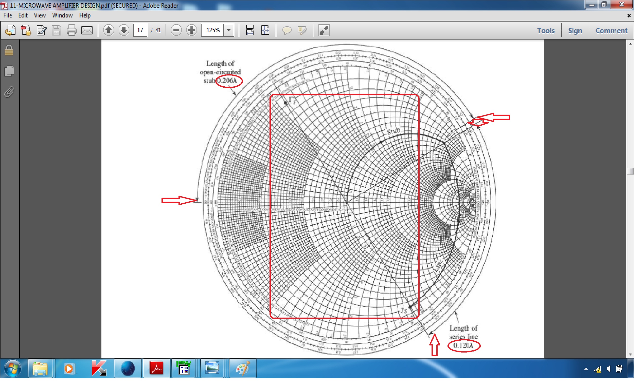

亲爱的先生,我想找到使用史密斯圆图的David .M.Pozer示例11.3的系列长度和开放存根长度。
我知道,如何找到Gamma_S和Gamma_L。 我不知道,如何找到导纳点Ys,以及如何绘制系列长度和开放存根长度,如David .M.Pozer的例子所示(第551页和David M.Pozer的第552页) 第3版)。 请帮我画出史密斯圆图。 我想使用ADS软件在ADS SMITH CHART实用程序图中绘制导纳点,系列和开放存根长度,而不是手动史密斯圆图。编辑:nimbargi于2013年11月11日上午10:15 以上来自于谷歌翻译 以下为原文 Dear Sir, I want to find the series length and open stub length for the David .M.Pozer example 11.3 using Smith Chart. I know, how to find the Gamma_S and Gamma_L. I don't know , how to find the admittance point Ys , and how to draw the series length and open stub length as shown in the example of the David .M.Pozer (page # 551 and page #552 of David M.Pozer 3rd edition). Please help me to draw the Smith chart. I want to draw it admittance point, series and open stub length in the ADS SMITH CHART utility graph using ADS software, not manual Smith chart graph . Edited by: nimbargi on Nov 11, 2013 10:15 AM 附件

很难理解你需要什么(特别是没有书)。 你在ADS看过史密斯圆图工具吗? 在原理图中,转到工具>史密斯圆图。 以上来自于谷歌翻译 以下为原文 It is difficult to understand what you need (especially without having the book). Have you seen the Smith Chart Tool in ADS? In the schematic, go to Tools > Smith Chart. |
> {quote:title = nimbargi写道:} {quote}>现在我面临绘制系列长度和打开存根长度的困难我不明白你的问题是什么。
您已经显示了具有源和负载阻抗的Smith工具屏幕截图,没有任何匹配元素。 您在理解如何与史密斯圆图(理论)匹配时遇到问题,或者如何将理论应用于此工具(用户界面)。 或者您的问题是从电线参数到物理尺寸的转换? ~~由于版权原因,我认为你应该删除上面的书籍下载。 以上来自于谷歌翻译 以下为原文 > {quote:title=nimbargi wrote:}{quote} > Now I am facing the difficulty in drawing the series length and open stub length I don't understand what your problem is. You have shown the Smith tool screenshot with source and load impedance, without any matching elements. Is your problem in understanding how to do matching with the Smith chart (theory), or how to apply the theory to this tool (user interface). Or is your problem the conversion from electrical line parameters to physical dimensions? ~~ I think you should remove the book download above, for copyright reasons. |
lmksa 发表于 2019-1-14 09:08 Volker Sir,一旦我们使用ADS Smith图表实用程序知道Gamma_S,我就会遇到绘制匹配系列长度和打开存根长度的问题。 是的,由于版权材料,我将删除POZER章节。 以上来自于谷歌翻译 以下为原文 Volker Sir, I have problem with drawing the matching series length and open stub length, once we know the Gamma_S using ADS Smith chart utility. Yes I will remove the POZER chapter due to copyright material. |
hu_wflllllllg21 发表于 2019-1-14 09:20 > {quote:title = nimbargi写道:} {quote}>我有绘制匹配系列长度和打开存根长度的问题不确定我是否理解你在这个上下文中的“绘图”是什么意思,但试试这个:http:/ /www.microwaves101.com/encyclopedia/smithchart.cfm 以上来自于谷歌翻译 以下为原文 > {quote:title=nimbargi wrote:}{quote} > I have problem with drawing the matching series length and open stub length Not sure if I understand what you mean by "drawing" in this context, but try this: http://www.microwaves101.com/encyclopedia/smithchart.cfm |
先生,我已经阅读了这个链接材料,对我们的需求没什么用处。
如果我们知道Gamma_S和Admittance点,可以帮助我找到匹配的系列和开放的短线长度。 以上来自于谷歌翻译 以下为原文 Sir, I have gone through that link material, it is not much useful for our need. Can any help me to find the matching series and open stub length, if we know Gamma_S and Admittance point. |
